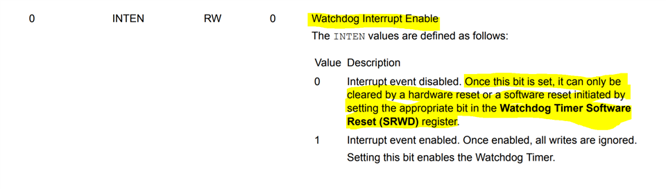

  • I think the problem is that once the application enables the watchdog, you cannot disable it except through a reset:
    If the application must use the watchdog I think you have two options:
    1) add watchdog support to the bootloader
    2) define your own function to check if the bootloader runs the application or stays in the bootloader. This function can check the reset source. If the reset source is the watchdog, then the function returns a non-zero and stays in the bootloader. Then you can actually force a watchdog reset to re-enter the bootloader instead of the SVC call at 0x2C.

  • Hi Bob,
    You might noticed below code disabled both watchdog resets, should keep dogs from asserting during BL code execution. It must be the MCU is resetting from catastrophic code failure entering BootP section.
    I'v tracked down part of the issue being UART0 GPIO PA0/PA1 when added to BootP() code execution toggle LEDS D1/D2 On then watch dogs reset MCU. Noticed several other make objects are being built that are not selected via bl_config.h see ssi, i2c, USB, UART, etc...

    					 //MAP_SysCtlSleep();
    						/* Unlock the watchdogs Eallow */
    						MAP_WatchdogUnlock(WATCHDOG0_BASE | WATCHDOG1_BASE);
                            /* Disable the watchdog timers */
                            MAP_WatchdogResetDisable(WATCHDOG0_BASE);
                            MAP_WatchdogResetDisable(WATCHDOG1_BASE);
                			/* Disable Watchdog interrupts */
                			HWREG(WATCHDOG0_BASE + WDT_O_CTL) &= ~(WDT_CTL_INTEN);
                			HWREG(WATCHDOG1_BASE + WDT_O_CTL) &= ~(WDT_CTL_INTEN);

  • Launching the demo projects with the serial bootloader on my Lauchpad does not cause Watchdog resets. You seem to be focusing on the bootloader. I suggest you set a breakpoint in the application on the call back to the bootloader and verify that the watchdog really was disabled.
  • Hi Bob,
    I finally got BL to work after loading newer version and adding above patches with one change below. Part of the issue was ORing the watchdog unlock is not allowed and mixing ROM with MAP calls in BL made it behave badly, MAP even breaks it on some EMAC0 function calls Tivaware v2.1.1.7.1. Are all ROM calls in the latter v2.1.2.111 and the later compilers LTS suffix seem to break BootP calls, v5.2.8 compiler builds ok. Had changed several calls to MAP after reading a post you made comment of how MAP trumps ROM, in this case it made things worse. Oddly I compiled BL v2.1.2.111 via v2.1.1.7.1 driverlib since build had errors to find EMAC0 configure LED's.
