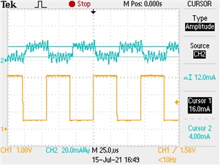

Scope screen captures:
Driving the opto is intermittent, but when on the switching frequency is between 1Hz and 30kHz.  When idle the GPIO pin is pulled up to 5V.
On one board the pin PH2 failed low, driving the opto.  The current sink capability specified in table 24-6 of the data sheet states up to 18mA at Vo = 1.2V.  We are well below that Vo level and below 18mA.

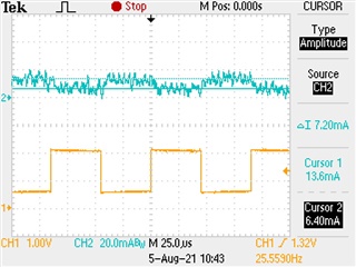

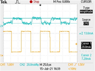

    The voltage and current measurements are summarized in the table below.  Scope screen shots follow.
    Board Pin VOH [V] VIL [V] IOH [mA] IOL [mA] Notes
    1002 Pan 2.6 0.5 7.20 16.80 Voltages read from scope screen capture
    1002 Tilt 2.08 0.56 6.40 13.60 Voltages read from scope cursors
    3004 Pan 3.3 0.5 7.20 20.80 Voltages read from scope screen capture
    3004 Tilt 3.1 0.5 4.00 16.00 Voltages read from scope screen capture

    Fig 1 - Board 1002, Pan:
    Fig 2 - Board 1002, Tilt:
    Fig 3 - Board 3004, Pan:

    Again, I'm sorry about the errors in my earlier report.  Having examples in hand now should eliminate that possibility in the future.

    For each measurement, the numbers reflect the high and low range of the square wave, correct? And from your point of view, the open drain can't pull it lower than 0.5V and therefore the stepper is not seeing a 'low transition' which is causing the issue?
    I want to understand this comment a bit better:
    a failure of the open-drain output to turn off completely.  I believe it continues to conduct enough current to keep the opto-isolator it drives active, effectively disabling the stepper motor since there are no transitions.
    The main reason I am trying to hone in on this assumption is because right now looking at the measurements, the only one that is out of spec is the Tilt signal on Board 1002 as VOH should be minimum 2.4V.
    VIL assuming a 3.3V supply can range from 0 to 1.155V per datasheet:
