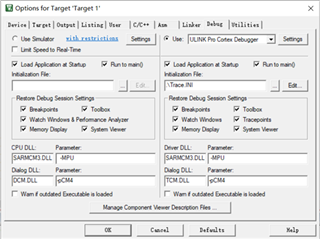

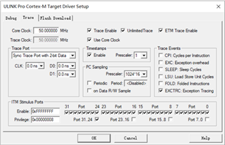

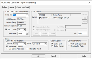

Our customer needs ETM function with Keil5 IDE, they followed the steps below, but got the Trace: Data Stream Error
Hardware:
Traceclk with PF3,Tracedata[0] with PF2,Tracedata[1] with PF1.

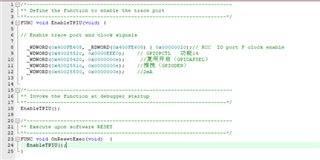

2. Software(use ULINK Pro):
The .ini file:
But they still get the error as below:
