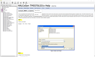

  • For testing purpose we are using HALCoGen code and we have enabled Dp83640 loopback. We have selected MII mode with full duplex mode. we receiving the data however we have observed data corruption.

      I don't know what went wrong. Did you run the HalcoGen example as is or you modified it? Can you double check all the steps mentioned in the example are followed?
    I found this post that may also help you debug.
    https://e2e.ti.com/support/microcontrollers/hercules-safety-microcontrollers-group/hercules/f/hercules-safety-microcontrollers-forum/686161/tms570ls3137-emac-module-is-initialized-but-no-packets-are-sent/2529181?tisearch=e2e-sitesearch&keymatch=emac%252520loopback%252520mode#2529181
  • We haven't modified the HalcoGen code, we have following questions as well,
