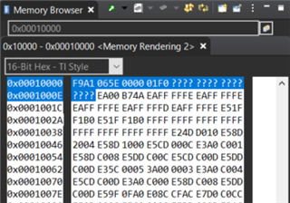

I have programmed erase/write flash function according to SPNU501H and SPNA148. It is working properly – the memory is erased and re-programmed. After that I want to write a CRC value into the flash in the same way.
But – when I read the location (blue highlight), where the CRC value (let's say 0xF9A1) should be - there is 0xFFFF. It seems to be an ECC error but...
The interesting thing is, that when I read (in CCS memory browser) a different location (and only if I click enter to choose it, scrolling does not have this impact) and then I go back and read the right location - voila - CRC value is there. The same happens when I reset the CPU - the CRC value is there - even after ECC check is turn on during start-up.

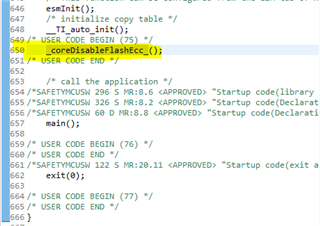

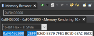

  • An update:
    1) when I turn the ECC check off before the CRC is written, everything works alright. But ECC bites in the dedicated ECC memory (I suppose it is 0xF0402000) seems OK to me - 0x2E for the first non-empty data words and 0xFF for the blank data rest.

    2) I use my own function according to SPNA148, and it works - the 0x10010 and further locations are erased and re-programed as You can see in the following picture:
    0x10000 (CRC location) is erased too, but not yet programed
    3) I use similar syntax, thank You. Closing and re-opening the memory browser does help too.

    (a) I program CRC value
    (b) in CCS memory browser I can see changed ECC bits for the 0x10000 - 0x10010 memory:
    (c) but neither in CCS memory browser, neither in code I can see the CRC value (e.g. 0x100)
    (d) if I try to write different data (e.g. 0x200) to the CRC location, after that, it does not have effect
    (e) because after a reset occurs or a different location is read meanwhile in CCS memory browser, there is 0x100 - now I can see (or the code) can see the CRC value
    The question is - why I (or the code) can't see the CRC value when (c) - there are correct ECC bits and (d) the data are clearly written at the location right the first try. And (e) why reset or read a different location in CCS memory browser helps?
