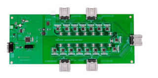

  • This sample code was developed for the board below. The TMS570LS0432, BQ79606 and TPS65381 are integrated onto this board.
    which board are you using?

  • Hi Praveen,
    You can toggle GIOA pins without connecting to BQ79x board to check if the GIOA pins toggle as expected or not.
    In your main():
    gioInit();
    gioSetDirection(gioPORTA, 0xFF); //config all GIOA pins as output
    gioSetPort(gioPORTA, 0xFF); //set all GIOA pins as HIGH
    gioSetPort(gioPORTA, 0x00); //clear all GIOA pins as LOW
    You can probe the GIOA pins to check if they are set or cleared.
