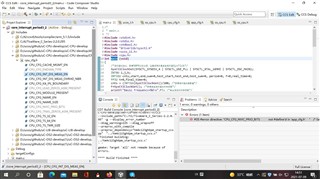

:”test core close interrupt time”experiment can’t work
1.I am a new learner about ucos_ii,and I use tm4c123gxl launchpad to work this exam.
2.I have programed the exam program and include the file which the exam program needs.But it can’t run before conect with tm4c123gxl.
3.The error is
Description           Resource               Path       Location                Type
#35 #error directive: "CPU_CFG_NVIC_PRIO_BITS         not #define'd in 'app_cfg.h'    "   /* See Note # 3            */                .ccsproject            /core_interrupt_period3_2             line 110, external location: D:\ucos\github\uC-OS2-develop(1)\uC-OS2-develop\Ports\ARM-Cortex-M\ARMv7-M\CCS\os_cpu.h   C/C++ Problem
It just like I can’t define the CPU_CFG_NVIC_PRIO_BITS.And I don’t know how to deal.
The program and include file have pakaged in appendix.
If you can deal with the problem,I will appreaciate it. Thank you for your reading.

      If you look at the directives under cpu_cfg.h you will find some of the directives grayed out. For example, the directive CPU_CFG_NVIC_PRIO_BITS is grayed out (with lighter color). You will need to look at the source file to understand the reason.
    Now if you open the cpu_cfg.h file you will see below. You have #if 0 directive. You must change it to #if 1 in order to have the CPU_CFG_NVIC_PRIO_BITS defined. This is more a C language usage question. Please refer to C language usage if you need further explanation.
  • Thank you for your advice.
    I have corrected the #if 1.
    But now here comes a new problem.I think it may be a problem about os_cpu_a.asm.However,I don't know how to deal with it.
    The error is
    #10010 errors encountered during linking; "core_interrupt_period3_2.out" not built    core_interrupt_period3_2             C/C++ Problem
    <a href="file:/C:/ti/ccs1031/ccs/tools/compiler/dmed/HTML/10234.html">#10234-D</a>  unresolved symbols remain    core_interrupt_period3_2             C/C++ Problem
    unresolved symbol OS_CPU_SR_Save, first referenced in ./main.obj    core_interrupt_period3_2             C/C++ Problem
    unresolved symbol OS_CPU_SR_Restore, first referenced in ./main.obj    core_interrupt_period3_2             C/C++ Problem
    I am sorry that now I can't send the error photo.But I hope it can be solved.Thank you for your reading.
