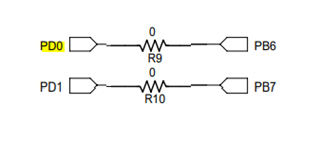

Simply, I'm trying to Interface nrf24l01+ (Wireless module) module through SSI0 (SPI), and it works perfectly. on PINS (PA 2 PA3 PA4 PA5)
When I try to switch to a different SSIn, for example, use SSI1 (SPI) on PINs (PD0 PD1 PD2 PD3) It never works?!!
Am I missing something special for SSIx which is not required for SSI0?
The following is the code related to the initialization of the SSIx I'm using for both cases 0 and 1
