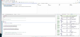

I have a question related to debugging by launching the target.ccxml. My problem is that the debug info is not loaded when I launch the .ccxml and connect to the target.
Let's assume I am trying to load blinky example;
If I start debugging by using the debug button there are no problems.
The code is resolved and I can put a breakpoint wherever I want.
However, if I launch the .ccxml and then connect the target, the debug information is not available.
What am I missing here? Is there an additional step to show the debug information to CCS when I debug it via launching the configuration?

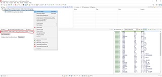

      In your first method by pressing the debug icon, the debugger will launch the target configuration, connect to the target and load your code by programming the firmware image to flash. In the second method where you manually launch target configuration and connect to the target, you need to also manually load the symbol of your application, in this case the blinky.out. Loading symbol will not reprogram the code but only load the symbol. See below.
