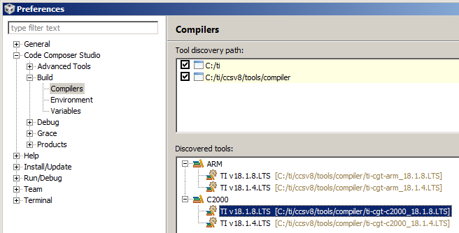

I use CCS 8.3.1 on Windows 7 32 bit. That's the latest version of CCS working on 32-bit Windows.

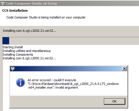

I have troubles of importing projects from C2000ware 3.04. That's due to absence of CGT 20.x, which is specified in .projectspec files of C2000ware. And I'm unable to install CGT 20.x to CCS 8.3.1 although I see it in the list of available updates (Help - Install New Software ...). When I select CGT >= 18.12 I see that update process tries to run some .exe with 'x64' substring in it's name (like ti_cgt_c2000_18.12.8.LTS_windows-x64_installer.exe). And of course this attempt finishes with an error.
And I'm unable to download something like ti_cgt_c2000_18.12.8.LTS_windows-x32_installer.exe (or just without 'x64') from ti.com. At the same time I couldn't find any information about OS requirements for any version of CGT.
Does it mean that starting from CGT >= 18.12 32-bit Windows is not supported anymore? Or maybe do I something wrong?
