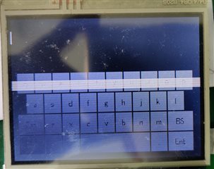

Now issue is one of screen i enable the user input field so click on user input field the keyboard display coming .
That is used for input the data but when  i click on ENT button background next button event fire.
How to disable that event.
If the next button not overlap with ENT of keyboard then working fine. How to disable background event.

  • Dear Sir,
    My LCD screen Error measurement with + and - button.(Attached for reference)
    Click on White field open the keyboard(attached)
    After pressing the keys on keyboard and press ent key then background + key of error measurment trigger and  display next another screen instead of same original screen of Error measurement.
  • HI,
      I'm not an expert on grlib. Perhaps you can reference the same code as  provided in the grlib_demo.c example. Here in this code, when a '+' button is pressed, it will do three things:
      1. Remove the current panel
      2. Add the new panel to the Widget tree
      3. Remove the '+' button if this is the last panel
      I think you can mimic this code for your pulldown button to bring up the keyboard. I suppose you can do something like below. I'm not sure if this will work or not. If you find a way to workaround the problem please share your idea with the community.
      2. Remove the '+' button
      3. Add the new panel (the soft keyboard) to the Widget tree
