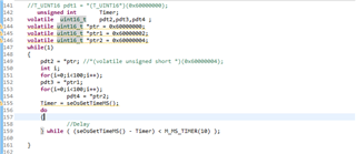

Also, attached snapshot of the code.

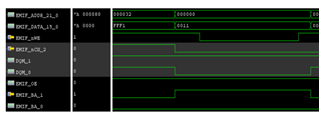

      I found a simulation waveform by our design team that shows the timing matching yours for 0x60000002. The BA[1] will select the upper byte.
    *(unsigned short *)  0x60000102   = 0x2233;

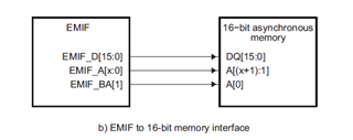

    Below is the description in the TRM.
    The EMIF address pin EMIF_A[0] always provides the least significant bit of a 32-bit word address. Therefore, when
    interfacing to a 16-bit or 8-bit asynchronous device, the EMIF_BA[1] and EMIF_BA[0] pins provide the
    least-significant bits of the halfword or byte address, respectively.

      I suppose you make the below connection to the 16-bit async memory. EMIF_BA[1] is connected to A[0] of a 16-bit memory. As you said, the EMIF_BA[1] is not used as a byte select but rather as an address bit. The first 16-bit memory location is accessed by 0x0 from the memory module perspective. The second memory 16-bit memory location is 0x1 from the memory module perspective. Since the BA[1] is connected to A[0] of the memory module, the BA[1] needs to be high in order to access the 2nd memory location. To access the the 3rd location which is 0x2, the EMIF_A[0] needs to be high and EMIF_BA[1] needs to be low. That is how I interpret it.
    Yes. Even our understanding was same as your interpretation.
    Ideally, to access 3rd location 0x02, EMIF_A[0] =1 and EMIF_BA[1] =0 .But we are seeing EMIF_A[0] =0 and EMIF_BA[1] =1. This looks like BA0 is the LSB and not BA1. Can you please clarify on this.
  • HI,
      In your table you showed EMIF_A[0] =1 and EMIF_BA[1] =0 for the third location which is 0x60000004. The 0x60000004 is the CPU address corresponding to 0x2 of the memory module. Basically, it is a right-shift by one bit.
