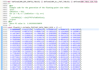

    Well it seems the (f) suffix has some controversial compiler actions upon the FPU, where printf() via switch (f) specifies double precision FPU operations. ARM engineers of CMSIS v5.7 suggest (f) suffix, e.g. (0.123456789f) mandates compiler Not preform double precision operation.
    According to TM4C datasheet (Pg.142) 7M4 FPU can not do double precision operations as noted IEEE 754 standard amended C99. Seems somebody is not following the IEEE rules and the compiler (float) appended (f) attempts to do double precision. Hence a float64_t somehow skirts around C99 and the FPU preforms single precision on a long long rather than a long adding double precision (f).

  • I noticed the CMSIS project compile flags had not added -mv7M4 --float_support=FPv4SPD16.  Yet the CMSIS project has runtime support selected (FPv4SPD16) but the flag was never added summary of compile flags. However the application only references this CMSIS DSP project build and application does set flags -mv7M4 --float_support=FPv4SPD16.
    The CMSIS project manager upon testing with compiler (clang) did not set symbol flag --define=__FPU_PRESENT=1 as the TI compilers add to summary of flags. Could it be their test build bamboozled was not even using 7M4 FPU for single precision float32_t operations rather Clang is simply adding floating CPU support for (f) suffix?
