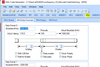

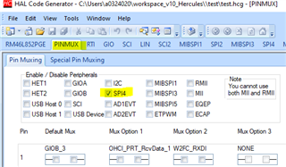

    Which SPI is used to communicate with RTC? The SPI signals may multiplexed with other signals. For example, pin 25 (144PGE package) is used for N2HET1[0]/SPI4CLK/EPWM2B, and this pin is used as N2HET1[0] by default. If you want to use this pin as SPI4CLK, the pinmux for this pin should be configured properly:1.
    1. enable SPI4 module:

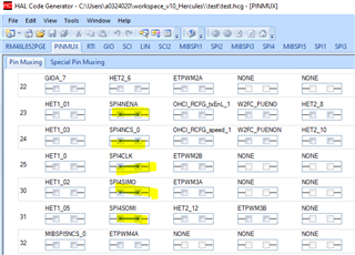

    2. Configure the pinmux
    The pins are automatically selected for SPI4
    3. Configure SPI4, then generate code
