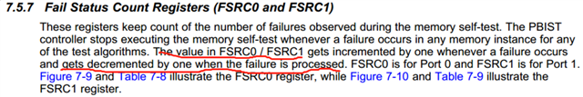

1 What is the process to reduce the value in FSRC0/FSRC1?
2  I choose to resume after the first self-test fails.  But the self-test fails again. Will this register record the address where the self-test failed again?

    What is the value of RAMT? Re-performing PBIST will not stop the error.
    There is one SW bug in pbiststop(). The pbistStop() function generated by HCG is missing a reset for the PBIST controller. The function below is the updated pbistStop(). Please update the routine generated by HALCoGen to match the following.
    void pbistStop(void)
    /* USER CODE BEGIN (20) */
        pbistREG->PACT = 0x0U;
        systemREG1->MSTGCR &= 0xFFFFFFF0U;
        systemREG1->MSTGCR |= 0xAU;
        systemREG1->MSTGCR |= 0x5U;
    /* USER CODE END */
    When you perform the PBIST, please make sure the memory group you selected for the test does exist in this device, and the proper algorithm is used for the test.
