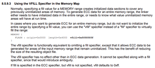

I see some TI's app notes and other places use vfill=.......   in linker command files, for flash.
But my TI ARM manual & the TI linker manual only have fill,  to "v"fill .
What is vfill ?..  Virtual fill ..? what does it do
