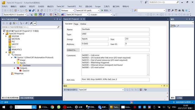

Hi, this is the problem I am having.
1.TwinCAT it scans but the box does not appear.
When I start TwinCAT scan I/O, there is no reminder that the slave is initializing, and LED2 and LED4 are not visible.
So what step did I do wrong, or did I leave out what configuration?
The following is the whole process of building the project:

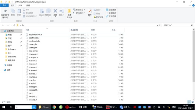

Step 1:I use the SSC Tool tool to generate the configuration files and ESI files needed by the slave

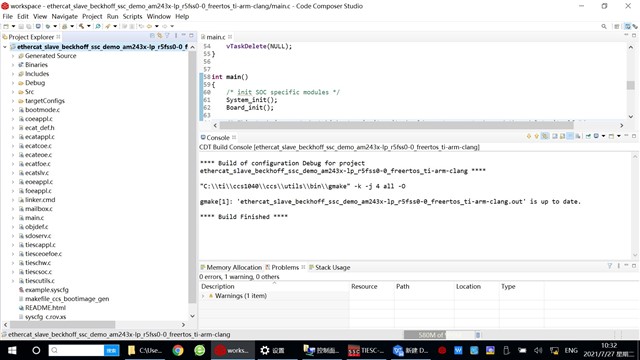

Step 2:Import Demo to build the appropriate project

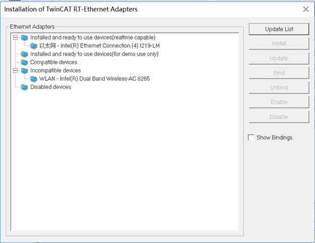

Step 3:Place the XML file in TwinCAT/3.1/Config/IO/EtherCAT folder, and create a new project on TwinCAT and check the Intel NIC driver

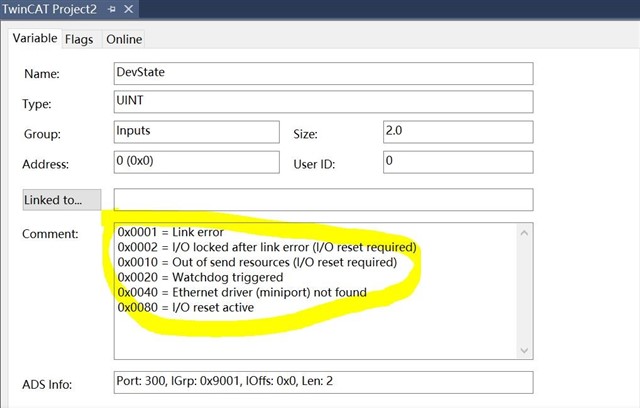

Step 5:There was no pop-up alert for activate Free Run when scanning I/O devices, and the following error was noted in the comments.
So I doubt that the AM243X is not in the initialized state, how do I set it up? And what other problems are there, is there a better solution?
