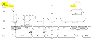

I am using TMS570LS1224 and configure with HalCogen , CCS.
How to get the Shutdown (SD) signal as shown in the picture with right timings with Halcogen and CCS?
tSDLCSL, tCSHSDH - timings
Can it be done without doing manually?
Actually, I need to make SD signal high after the transmission of data from SDI. How can I achieve it?
No, SPI module is not able to control other pin's action for example a GIO pin. if you use a GIOA[0] for SD:
0. Configure GIOA[0] as OUTPUT
1. Pull GIOA[0] LOW
2. call SPI transmit Function: spiTransmitData(...)
3. Pull GIOA[0] High
