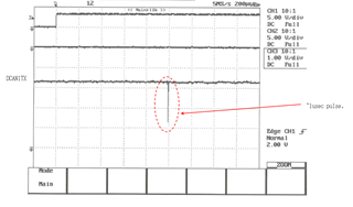

My customer reported a pulse is generated on DCAN TX signal when the module is reset by SWR bit in DCAN CTL register.
Please see below waveform.
Customer follows below sequence as recommended in TRM Table27-7 (and the original E2E thread).
The sequence is below:
1) Set Init bit
2) Set SWR bit
3) Wait until SWR gets 0. (The pulse is generated here)
Could you tell me how to avoid the pulse?
