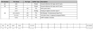

I want to generate PWM signal .
Can I use PD4 as PWM generator?
In multiplexing the PD4 is not showing as PWM whereas Pin details its show as PWM0 .Kindly refer below image.
Some conflict
PD4-----A4----AIN7----U2RX-----T3CCP0-----SSI1XDATA2
  • Hello Rajesh,

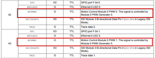

    PD4 in the datasheet is showing that it is a Timer pin which is PWM capable from the Timer peripheral. This is not a pin that is in the PWM peripheral. You can configure that timer to use it as a PWM but you wouldn't have all the feature the PWM module gives.
    The below image shows how PWM peripheral outputs are marked in the datasheet:
    Ralph Jacobi
