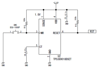

Hello Koki,
Do you have the reset pin pulled to VCC with a resistor? If so, what value?
Can you confirm when the button is turned on, the voltage on the MSP432 Reset pin goes to 0v?

Hi, Dennis
The figure below shows the resistance value and capacitance value to the reset pin.
I confirmed that the voltage transitions to 0V when the reset button is pressed.
