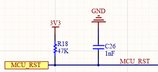

Schematic for rst pin. (pull up resistor 47k and pull down capacitor 1nF.
Schematic for the rest of the pins. JTAG TCK pull down resistor 10k  and JTAG TMS pull up resistor 10k.

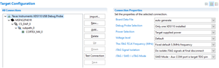

In order to program the chip I set the target with the following parameters.
Then launched this configuration and connected the target, made a factory reset and restart the target.
Again, launch the configuration, connect the target and load the file to the target. In this moment the error appears. Also this error appear if I choose the option verify the program.

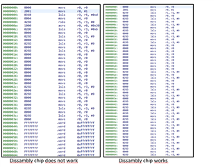

When I check the disssembly page I realized that from 0x0000003e the chip is not overwritten in contrast to the chip (that works) on the launchpad.
