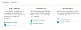

    I think the best testimonial I can give for TM4C right now is that at the start of this year, we moved TM4C out of the 'Other Microcontroller' category it had been placed in on TI.com to instead be featured on our Arm Microcontrollers page. This move was very deliberately done to send a clear message that TM4C is still an active and supported family and should be considered for new designs still: https://www.ti.com/microcontrollers-mcus-processors/microcontrollers/arm-based-microcontrollers/overview.html
    (Image from https://www.ti.com/microcontrollers-mcus-processors/microcontrollers/overview.html)
