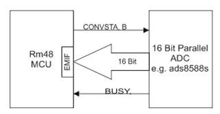

Dear Forum,
I ‘am developing a signal application with medium computational demand and possible safety relevance. Therefore I need measure several signal simultaneously.
As MCU I am planning to use a Hercules MCU, as ADC I want to attach a high speed parallel interface ADC (propably an ads8588s).
The maximum sample frequency of the channels will not go beyond 100 kHz, but each sampling will result in 8 channel (à 8 Words to transfer).
Because of the signals nature the will slightly wobble by a few percent (probably N2HET will be used to produce the CONVSTA, CONVSTB Signals). The Sampling is ongoing continuously in time.
Each end of conversion will be signalled by the BUSY Signal. From control theory perspective burst of several sampling could be transferred to RAM before they need to be evaluated, so DMA group transfer is possible.
Q: What is the most efficient way to transfer the result to a Hercules MCUs RAM?
Q: could the DMA be used? Does it make sense?
Q: is there any other way to connect a Hercules MCU to a high speed ADC?
