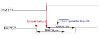

My understanding of the ESM - nERROR  dependency was that the nERROR-Pin is always in LOW state, when there is an error bit set in one of the ESM registers. Which would mean that the nERROR pin can not be reset while the Error in the ESM is not cleared.
But when looking at the documentation again, Figure 16-7 in the Techhnical reference Manual suggests otherwise:
For clarification I added the state of the ESM 2.19 bit to Figure 16-7.
(Q1) Is it possible to reset the nERROR Pin although an error like ESM 2.19 is still present und not cleared?
Thank you and best regards,
Max

  • Hi QJ,
    Thank you for your fast reply.
    What  I am wondering is, could doing an error forcing test like CPU8 which would trigger ESM 1.2 and the nERROR Pin (if so configured) leed to a real error not beeing detected? Because the nERROR gets trriggered by this Test we would need to reset the pin with a reset request immediatly.
    What I am worried about is that another ESM Error that is signaled after the reset request would leed to nERROR beeing reset despite there beeing an error present.
    Is this possible?

  • Hi QJ,
    Thank you for the clarification.  This basicly means, that it is possible for an error beeing present, without nERROR = LOW, as show in the attached image.
    Is there a way to prevent the nERROR reset, when there is an error present in the ESM?
    Max

  • Hi QJ,
    I understand that the ESM just sets the nERROR = LOW and for a reset I have to request a nERROR resett hrough ESKEKR. What I am concerned about is that after the request is set, another error could occur. In the image I posted that would be ESM 3.9.
    In that case, after the specified LOW-time of nERROR ESM 3.9 would still be set, but nERROR would be HIGH.
    Is my understanding correct?
  • The nERROR pin will keep LOW. Writing 0x5 to ESKEKR during nERROR=LOW does not impact the following error.
    If you want to reset nERROR, you need to write 0x5 to ESKEKR after ESM3.9 is set.
  • Hi QJ,
    Thank you for the clarification. So the behaviour in the image I posted is incorrect and the correct behaviour would be the following?
    Max
  • Max,
    Yes, you are correct.
