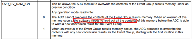

Hi QJ Wang,
for below document claim the software need read out all the contents. this means read out in FIFO queue or read out from memory directly?
Yes. If OVR_RAM_IGN is cleared (=0), your code has to read out the conversion results, otherwise the new conversion results are discarded.
