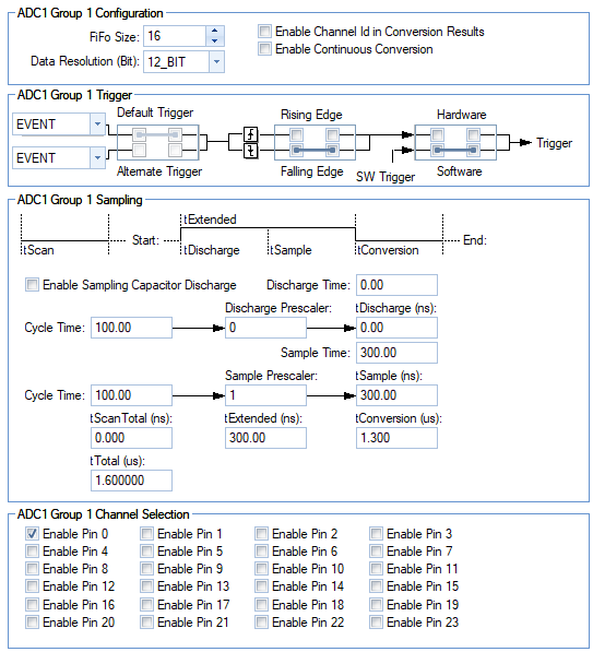

Hi, I'm currently trying to use ADC 1 peripheral on RM48L952 but it seems to be stuck on busy.
    adcData_t testAdc;
    _enable_interrupt_();
    _mpuInit_();
    _mpuEnable_();
    adcInit();
    adcEnableNotification(adcREG1, adcGROUP1);
    adcStartConversion(adcREG1, adcGROUP1);
    while(!adcIsConversionComplete(adcREG1, adcGROUP1));
    adcGetData(adcREG1, adcGROUP1, &testAdc);
Looking at registers it seems to be ok but the program is stuck at while(!adcIsConversionComplete(adcREG1, adcGROUP1));.
A point to note is that my device has only AD1IN[0] connected and ADREFHI, ADREFLO, AD1EVT are not, just trying to see if adc peripheral works. I think that's not the problem but it might be worth noting.
Also ADC1 Group 1 in VIM channel is not enabled.
Here is adc group 1 setting. I haven't tinkered sample timing.
Below is some registers at waiting loop.
