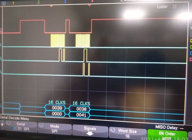

    As i am using the loopback example (SSI1 - slave, SSI0 - master) I write first from the slave and then from the master
    as in the example beneeth - nothing is seen on the MISO line, only on the MOSI.
    for(ui32Index = 0; ui32Index < 2 ; ui32Index++)
    MAP_GPIOPinWrite(GPIO_PORTD_BASE,GPIO_PIN_4, 0);
    MAP_SSIDataPut(SSI1_BASE, pui32DataTx1[ui32Index]);
    MAP_SSIDataPut(SSI0_BASE, pui32DataTx[ui32Index]);
    for(jj=0; jj<22;jj++);//wait - needed
    MAP_GPIOPinWrite(GPIO_PORTD_BASE,GPIO_PIN_4, GPIO_PIN_4);
    if I add another - MAP_SSIDataPut(SSI1_BASE, pui32DataTx1[0]); line before the above i get only the second array value.
    Meaning , I send one word from slave then a word frome master (no response from slave)
    then another word from slave and the first slave sent value is seen.
    how can I have a slave answer on the first master sent value too?
     You need to wait until the transmission is complete before de-asserting the chip select to high. I modified the example to use GPIOA3 for chip select and it works for me.

  • Sorry, I also see 0 on the SOMI. Let me take a look.
  • Ok, I got it working. See below snippet of code. Looks like we need to fill the slave TXFIFO with the data first before receiving the clock from the master. The way it was before, the slave TXFIFO has no data yet at the time when it receives the SPICLK from the master. Therefore, it transmits 0 instead. I think this is matching the datasheet description. Just make sure there is already some data in the slave TXFIFO before the master sends the clock.

    In slave mode, the legacy SSI transmits data each time the master initiates a transaction. If the
    transmit FIFO is empty and the master initiates, the slave transmits the 8th most recent value in the
    transmit FIFO. If less than 8 values have been written to the transmit FIFO since the SSI module
    clock was enabled using the Rn bit in the RCGCSSI register or if the QSSI is reset using the SRSSI
    register, then 0 is transmitted. Care should be taken to ensure that valid data is in the FIFO as
    needed. The QSSI can be configured to generate an interrupt or a μDMA request when the FIFO
    is empty.
