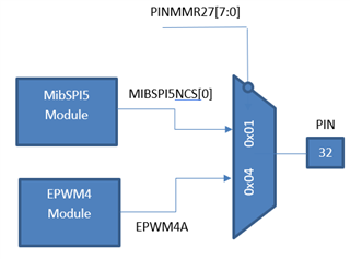

  • Yes, it is PINMMR27. Each byte in the PINMMRs control the functionality output on a single terminal. From table 4-21 of TRM, PINMMR27[7:0] control the multiplexing between MIBSPI5NCS[0] and EPWM4A on the PIN 32. The default function on PIN 32 is MIBSPI5NCS[0] which is indicated by bit 0 of the PINMMR27 register being set.
    If you want to use PIN 32 as EPWM4A signal, bit 2 (bit 1 is not correct in my previous post) of PINMMR27 must be set and bit 0 must be cleared. Other bits of PINMMR27[7:0] are reserved.
    The MIBSPI5NC[0] can be used as SPI function pin or GIO pin, which can be configured via SPIPC0 register.

  • The PINMMR27[7:0] is used to select signal for Pin 32: MIBSPI5NCS[0] or  EPWM4A. Bit 0 of PINMMR27 register is for MIBSPI5NCS[0], and Bit 2 is for EPWM4A.
    PINMMR27[7:0] = 0x01  --> Pin 32 is used for MIBSPI5NCS[0]  ---> MIBSPI5NCS[0]  (SPIPC0[0] = 1)
                                                                                                         ----> GIO (SPIPC0[0] = 0)
    PINMMR27[7:0] = 0x04  --> Pin 32 is used for EPWM4A
