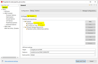

I'm working with the Tiva RTOS and I'm having issues debugging the project. Please find below the terminal messages and the ROV information.
The weird thing is that even if I get that error ROV if I flash the firmware directly I works fine. I need to debug it since I'm still developing the code.
Thanks in advance!
