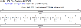

  • The EFC Autoload Error flag will set when the autoload fails. It is the bit10 of the EFCPINS register in the EFC module.

  • Hi Marcus,
    Yes, you are correct. EFC self-test can be used to validate the ECC logic after the device reset is released. For safety critical application, the user needs to check the status of EFC or status of ESM group 3 after the device is reset. The suggested flow chart for checking EFC is shown in Figure 33-1 in TRM.
    The ESM 3.1 means the error is a server error. The external safety monitor needs to be configured to put the system in a safe state when nERROR is asserted.
