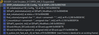

    MSP432 SPI API SD Card fails to transition to Idle Mode
    int_fast16_t SDSPI_initialize(SD_Handle handle)
        SD_CardType          cardType = SD_NOCARD;
        uint8_t              i;
        uint8_t              ocr[4];
        uint8_t              txDummy[10] = {0xFF, 0xFF, 0xFF, 0xFF, 0xFF,
                                           0xFF, 0xFF, 0xFF, 0xFF, 0xFF};
        int_fast16_t         status;
        uint32_t             currentTime;
        uint32_t             startTime;
        uint32_t             timeout;
        SPI_Params           spiParams;
        SDSPI_Object        *object = handle->object;
        SDSPI_HWAttrs const *hwAttrs = handle->hwAttrs;
        SemaphoreP_pend(object->lockSem, SemaphoreP_WAIT_FOREVER);
         * The CS line should not be asserted when attempting to put the
         * SD card into SPI mode.
        deassertCS(hwAttrs);
         * To put the SD card in SPI mode we must keep the TX line high while
         * toggling the clock line several times. To do this we transmit 0xFF
         * 10 times. Do not assert CS during this time
        status = spiTransfer(object->spiHandle, NULL, &txDummy, 10);
        if (status != SD_STATUS_SUCCESS) {
            SemaphoreP_post(object->lockSem);
            return (status);
        /* Now select the SD Card's chip select to send CMD0 command */
        assertCS(hwAttrs);
         * Send CMD0 to put the SD card in idle mode. Depending on the previous
         * state of the SD card, this may take up to a couple hundred milliseconds.
         * Rather than delay between attempts, we try up to 255 attempts.
         * Failure is returned if the card does not respond will a valid byte
         * within 255 attempts. When the card will respond with 0x1 when its
         * in idle mode.
        for (i = 255, status = 0xFF; i > 0 && status != 0x1; i--) {
            status = sendCmd(object->spiHandle, CMD0, 0); // Fails to send
        /* If the card never transitioned into idle mode */
        if (status != 0x1) {
            return (SD_STATUS_ERROR); // Returns here
        // More Code below but taken out for this TI Forum Post

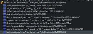

    The first f_open is where it tries to open a file for writing or create it if it does not exist.
    Call Stack

        if (send_cmd(hwAttrs, CMD0, 0) == 1) {// Succeeds here
             * Determine what SD Card version we are dealing with
             * Depending on which SD Card version, we need to send different SD
             * commands to the SD Card, which will have different response fields.
            // Succeeds here but fails in MSP432 SDSPI SDK
            if (send_cmd(hwAttrs, CMD8, 0x1AA) == 1) {
