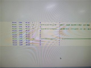

   First of all, I met a problem when I debug my uart_bootloader code and the code is totally same as the this link: .
   Here are the questions:
   1. When I use secureCRT to transmit .bin file,  the terminal would show below:
 , which means that the program  gets stuck here;

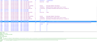

then I use  serial port monitor and find out the secureCRT sends first packet
  ,   there are no response  such as ACK or NAK but just CRC.

  • I just did a loopback test, there is no problem: sciREG4->Rd = sciREG4->Td
    The SCI4 signals are not routed to connectors, so I am not able to test the bootloader on SCI4.
  • So in your test, there is no problem to use SCI4  port as uart_bootlaoder?
  • I didn't see any issue with my loopback (digital and analog) test. I am not able to test bootloader using SCI4 since SCI4 signals are not routed to the connectors on launchpad.
  • what is the function of sciEnableNotification()? To set the rx interrupt? Is that necessary in uart_bootloader? or just in loopback mode?
    I just did a test on HDK. The SCI4 works fine.
    My setup is:
    SCI3 RX is connected to SCI4 TX
    SCI3 TX is connected to SCI4 RX
    SCI3 TX data, and the SCI4 gets the same data.
    sciEnableNotification() is used to enable the UART bootloader. The UART bootloader doesn't not require UART bootloader.
  • Finally, I set baudrate to 9600, then SCI4 can receive the data with Ymodem protocl.However, after MCU finishing receiving all data, the MCU will still reply C(CRC) and will  not stop. Then I using serial monitor, I found that secureCRT send the EOT ,then MCU will reply ACK, after that MCU will always reply CRC.

  • By thw way, Here are three pictures are what I tested with my code:
    1. upper computer finishes sending binary file, and MCU keep replying CRC:
    2. SecureCRT with "Send Xmodem" when at EOT:
    2. SecureCRT with "Send Ymodem" when at EOT:
