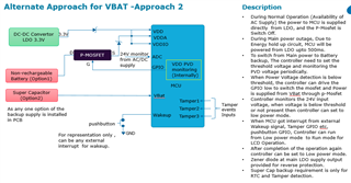

We have one requirement to operate the Peripheral (I2C) during battery operation to drive the LCD display when external wakeup is asserted.
From the datasheet i found that during hibernation mode (main power is absent and MCU powered in vbat) , even when external interrupt or wakeup signal is asserted (for eg push button) the MCU wont come out of hibernation untill vdd is present. could any one suggest or clarify wheather MCU peripheral section also can be powered by vbat when external wakeup signal is asserted?
Also suggest any TI MCU which can supports this function (operating the few peripherals on Battery operation) would be helpful.
