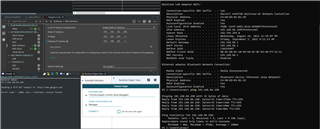

While DHCP works, setting a static IP does not work. I can confirm that the device is able to access internet. Any tips or steps I could be missing?
I did not touch DNS Server or DHCP Server Tabs on Sysconfig. I have tried using external DNS 8.8.8.8 as well in NDK Stack
The related post linked above did not use a website that works.
The Ip is not listed as static for some reason even after setting it via sysconfig
I tried the suggestion in this post as well using a custom function.

  • Hello James,
    That worked but there is a catch.
    1. A delay of at least 2-3 seconds is required before calling
     ret = HTTPClient_connect(httpClientHandle, HOSTNAME, 0, 0);
    2. An equivalent Task of priority set the same as of the pthread for *httpTask in in httpget.c does not work. Even if I wait for Task_sleep(10000) seconds.
    3. Setting high priorities for either task or pthread implementation fails with network handle closing.
    Any insights as to why this would not work in a task context? I tried this both on a MSP432E401Y launchpad and a custom board with EK-TM4C129EXL processor using segger debugger.
    Utsav

  • This is with pthread priority 10 as well as Ti rtos task priority 10
    I'm more interested in using Ti-rtos thread type rather than pthread. I thought the implementations should be interchangeable. Why is that not the case?
    I call this function before creation of httpTask or httpThread below. I made a slight modification to answer in the linked post by passing the Config handle and setting it as a hook in .sysconfig
