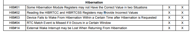

  • Hi Susan,
    HIB#1 - Some Hibernation Module Registers may not Have the Correct Value in two Situations.
      I don't think the two situations apply to the problem description as the RTCEN and PINWEN are both set.
    HIB#2 - Reading the HIBRTCC and HIBRTCSS Registers may Provide Incorrect Values
      This errata may be something to look into further. Can customer take the workaround and try if it makes a difference?
    HIB#3 - Device Fails to Wake From Hibernation Within a Certain Time after Hibernation is Requested
      I don't think this one applies. For this errata to happen, the wake event has to happen with 32uS before nHIB signal is asserted until VDD drops below BOR or the POR falling edge. The customer's wake event is actually 7am the next day, it is way over 32uS. If you have in doubt, you can add the workaround too but I doubt this errata is applicable.
    HIB#4 - RTC Match Event is Missed if it Occurs in a Certain Window
      Again, this errata only happens if the match occurs with 92uS (3 RTC clocks) after the setting the HIBREQ bit. Customer's match value will be 7am the next day after setting HIBREQ. It is way over 92uS. It doesn't hurt to try the workaround if in doubt.
    HIB#14 External Wake Interrupt may be Lost When Returning From Hibernation
      I believe the customer is using the RTC wake to wake up at 7am, correct? It is not that customer uses external nWAKE pin to wake up the device at 7am, right? So I don't think this errata applies.
      Can you confirm if customer follows the TivaWare hibernate example, will it work?
