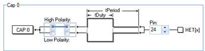

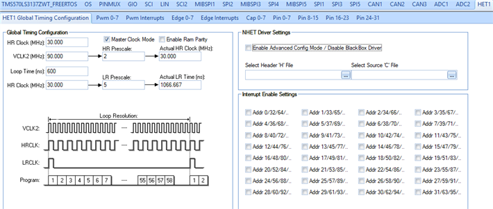

Although I have made the necessary configurations from halcogen and CCS software, I cannot obtain stable data. When I generate PWM and read it with capture mode, the data I get is always correct, but it does not detect gnd and idle status.
I would be very happy if you could help with this.
Halcogen Config:
CCS Code Config:

    The instruction PCNT is used to capture PWM signal. The PCNT is not able to capture the signal without edge transition (falling edge or rising edge).

  • Hi Eyup,
    If there is no no edge detected for long time, the PCNT counter gets overflowed (all 1’s in the counter value), then PCNT stops counting until the next reset
    edge is detected.
    I don't how to test the signal in system level.
  • I calculated the instantaneous logic state and period-task value of a signal using the capGetSignal() and gioGetBit() functions from the same pin. I made the capture value sensitive to the GND pin with a small software plugin. Since I haven't done static analysis yet, I don't know about Misra's suitability, but I wanted to share it.
