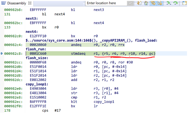

Problem statement:
In the OS which is used in my SW, there were 32 timed tasks (periodic tasks) configured in the SW.
The disassembly of copyAPI2RAM API was as below.
But whenever there were more than 32 timed tasks (periodic tasks) configured, my SW didn't reach main() at all.
There was always a RESET that was happening at the execution of _copyAPI2RAM_();
It is the same function copyAPIRAM() that is being executed.
But couldn't understand why the compiler changes the disassembly instruction for the very same API which had no changes linked to this _c_int00();
Could someone please share your views on this?

  • Hi Sharmili,
    The flash API section in Flash is not changed which is at 0x20060, and the section size is also the same: 0xF68.
    Can you try the this asm code? I just re-org the code.

  • Hi Wang, thanks for sharing this approach to solve the problem.
    Yes - I have tried this option and could see the SW running.
    But I am more curious in understanding the contribution of this re-organized code in fixing our problem.
    Any idea on what could be the root cause for this issue?

  • But couldn't understand why the compiler changes the disassembly instruction for the very same API which had no changes linked to this _c_int00();
    The highlighted address 00098244 contains a constant for the address of flash_run, rather than an instruction. I.e. shouldn't be executed.
    From the disassembly it looks like something has gone wrong with the _copyAPI2RAM_ symbol pointing at some constants rather than the first instruction of the function.
    Can you show the  sys_core.asm source file?
    Looking at HALCoGen I can't see see copyAPI2RAM being defined.
  • Hi Chester Gillon,
    PFA for the sys_core.asm file.

    ; Copy the Flash API from flash to SRAM.
        .def     _copyAPI2RAM_
        .asmfunc
    _copyAPI2RAM_
       .ref    api_load
    flash_load   .word api_load
       .ref    api_run
    flash_run   .word api_run
        .ref    api_size
    flash_size  .word api_size
         ldr    r0, flash_load
         ldr    r1, flash_run
         ldr    r2, flash_size
         add    r2, r1, r2
    copy_loop1:
         ldr     r3, [r0], #4
         str     r3, [r1], #4
         cmp     r1, r2
         blt     copy_loop1
          bx     lr
        .endasmfunc

    The code is the following, in which the there are 3 .word statements between the _copyAPI2RAM_ label for the start of the function and the actual first instruction which is ldr    r0, flash_load :
        .def     _copyAPI2RAM_
        .asmfunc
    _copyAPI2RAM_
       .ref    api_load
       .ref    api_run
        .ref    api_size
         ldr    r0, flash_load
         ldr    r1, flash_run
         ldr    r2, flash_size
         add    r2, r1, r2
    copy_loop1:
         ldr     r3, [r0], #4
         str     r3, [r1], #4
         cmp     r1, r2
         blt     copy_loop1
          bx     lr
        .endasmfunc
    The means when _copyAPI2RAM_() is called the contents of the .word's, which contain the address of api_load, api_run and api_size get executed as instructions, which can lead to a crash.
    The updated assembler which QJ Wang posted has re-ordered the assembler statements to avoid this problem.
