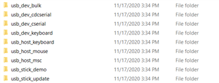

Thanks for the info. In that case, we don't have any plug-and-play (non HID and Mass Storage) WCID USB implementation examples in TivaWare. Below are all USB examples we have.
