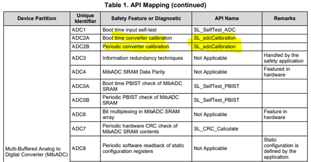

    I assume that selection of the SDL is something that is done when generating the HALCoGen code but unfortunately that was done before I joined the company, so is there a way to tell from the code that I do have, whether it was gen'ed with this enabled; for instance, what is the name of the function you  are referring to?
    Marcus
  • Hi Marcus,
    HALCoGen was developed before SafeTI diagnostics library hence there are few overlapping Safety Diagnostics features between them. We continue to support HALCoGen diagnostics ( sys_selftest.c) for legacy reasons. We strongly recommend to use SafeTI Diagnostics library for Safety Functions.
    The ADC converter calibration can be mapped to SL_adcCalibration():
       (software safety manual in SDL installation folder)
