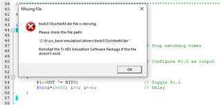

1- I am using MSP432 P401R LaunchPad (MSP-EXP432P401R). I downloaded BlinkLED example, successfully build it in Keil uVision5. But when I tried to download (F8) on my board, MSP-EXP432P401R, I am getting this error:
I have check the folder and it contains the required file. I installed ti_emupack (64bit). Can someone help me how can I get rid of this message?

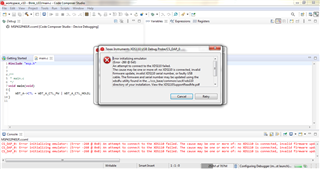

2- I opened cmd prompt. Changed director to C:\ti\ccs_base\common\uscif\xds110>
Entered: xdsdfu -m
Next entered: xdsdfu -f firmware_3.0.0.13.bin
After first or second command, green LED of my board turned off and it never turned on again. I have tried to connect multiple times but each time my board is seems to be dead.
Can someone tell me is my board dead? Can I recover it to factory reset state?

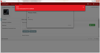

3- I am trying to access different documents on TI website, e.g.,
https://www.ti.com/lit/pdf/slau575
but I am getting such error messages:
Can someone guide me what is the problem?
