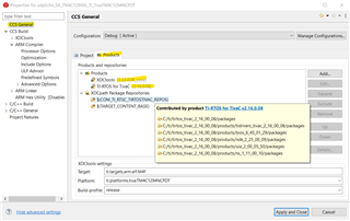

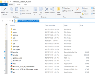

When i try to build any example under TiRtos for Tiva C I always get the error below,when i import the project into the ide i get a warning saying
No XDCtools, equivalent to the specified version '3.32.0.06_core', are available - defaulting to '3.62.1.15_core'.
**** Build of configuration Debug for project mutex_EK_TM4C123GXL_TI **** "C:\\ti\\ccs1040\\ccs\\utils\\bin\\gmake" -k -j 32 all -O Building file: "../mutex.cfg" Invoking: XDCtools "C:/ti/ccs1040/xdctools_3_62_01_15_core/xs" --xdcpath="C:/ti/tirtos_tivac_2_16_00_08/packages;C:/ti/tirtos_tivac_2_16_00_08/products/tidrivers_tivac_2_16_00_08/packages;C:/ti/tirtos_tivac_2_16_00_08/products/bios_6_45_01_29/packages;C:/ti/tirtos_tivac_2_16_00_08/products/ndk_2_25_00_09/packages;C:/ti/tirtos_tivac_2_16_00_08/products/uia_2_00_05_50/packages;C:/ti/tirtos_tivac_2_16_00_08/products/ns_1_11_00_10/packages;" xdc.tools.configuro -o configPkg -t ti.targets.arm.elf.M4F -p ti.platforms.tiva:TM4C123GH6PM -r release -c "C:/ti/ccs1040/ccs/tools/compiler/ti-cgt-arm_20.2.5.LTS" --compileOptions "-mv7M4 --code_state=16 --float_support=FPv4SPD16 -me --include_path=\"C:/Users/USER1/workspace_v10/mutex_EK_TM4C123GXL_TI\" --include_path=\"C:/Users/USER1/workspace_v10/mutex_EK_TM4C123GXL_TI\" --include_path=\"C:/ti/tirtos_tivac_2_16_00_08/products/TivaWare_C_Series-2.1.1.71b\" --include_path=\"C:/ti/tirtos_tivac_2_16_00_08/products/bios_6_45_01_29/packages/ti/sysbios/posix\" --include_path=\"C:/ti/ccs1040/ccs/tools/compiler/ti-cgt-arm_20.2.5.LTS/include\" --define=ccs=\"ccs\" --define=PART_TM4C123GH6PM --define=ccs --define=TIVAWARE -g --gcc --diag_warning=225 --diag_warning=255 --diag_wrap=off --display_error_number --gen_func_subsections=on --abi=eabi " "../mutex.cfg" making package.mak (because of package.bld) ... generating interfaces for package configPkg (because package/package.xdc.inc is older than package.xdc) ... configuring mutex.xem4f from package/cfg/mutex_pem4f.cfg ... subdir_rules.mk:19: recipe for target 'build-1615055615-inproc' failed error: xdc.cfg.Program: "C:/ti/ccs1040/xdctools_3_62_01_15_core/packages/xdc/cfg/Program.xs", line 71: xdc.cfg.Program : The package 'ti.sysbios.knl' is not compatible with XDCtools used in this build. Please either use XDCtools compatible with that package, or update the product containing that package, or rebuild the package with XDCtools 3.50 or later. js: "C:/ti/ccs1040/xdctools_3_62_01_15_core/packages/xdc/cfg/Main.xs", line 160: Error: Configuration failed! gmake.exe: *** [package.mak:202: package/cfg/mutex_pem4f.xdl] Error 1 js: "C:/ti/ccs1040/xdctools_3_62_01_15_core/packages/xdc/tools/Cmdr.xs", line 52: Error: xdc.tools.configuro: configuration failed due to earlier errors (status = 2); 'linker.cmd' deleted. gmake[1]: *** [build-1615055615-inproc] Error 1 gmake: *** No rule to make target 'build-1615055615', needed by 'configPkg/compiler.opt'. gmake: *** No rule to make target 'build-1615055615', needed by 'configPkg/linker.cmd'. gmake: *** No rule to make target 'build-1615055615', needed by 'configPkg/compiler.opt'. gmake: *** No rule to make target 'build-1615055615', needed by 'configPkg/compiler.opt'. gmake: Target 'all' not remade because of errors. **** Build Finished ****
