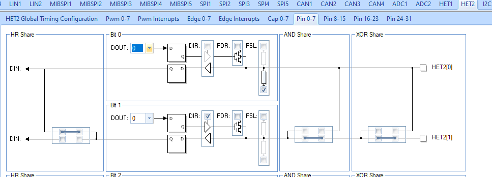

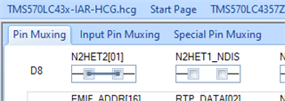

Hi all,
I am trying to use HET2_1 as a HW-Trigger for ADC1_GRP1. HET2_1 is part of the alternate trigger group. I successfully tried to trigger with HET1_27, just to make sure it works in principle.
I measured 100Hz (as expected) on HET2_1. Not sure what I am missing, here are my Halcogen settings.
Thanks in advance for your help.
Juergen
