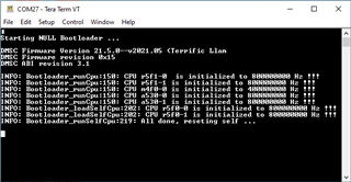

I am currently following the AM243X MCU+ SDK instructions and I was able to successfully all steps in the Getting Started section until the CCS Launch, Load and Run subsection
I ran the Hello World example, but it would not output anything.
Below is the correct output from the MCU+ SDK page.
What step have I missed for it to not output anything?

  • Hi Mari,
    What platform are you using for the testing? AM243x EVM or LP?
    Did you see the following display from UART?
    Ming
  • Hi Ming,
    Sorry for the lack of information! I am using the EVM.
    Yes, it displays the output from UART as you attached in the image.
    When I run the Hello World example, it produces no output after.
    Mari
  • Hi Mari,
    Did you import the "hello_world_am243x-evm_r5fss0-0_freertos_ti-arm-clang"? build, load and run it on MAIN_Cortex_R5_0_0?
    Did you see the CCS console output?
    Which CCS version you are using?
    You may try to power cycle the EVM and try again.
    Ming
  • Hi Ming,
    Yes, I imported the above and build, loaded, and ran it on MAIN_Cortex_R5_0_0.
    Nothing was output on the CCS console as well. I'm using CCS v 10.3.1.
    I've also tried to power cycle a couple of times and it still will not print. Not sure what the issue is.
