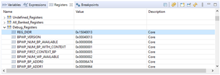

My question is for any of the TMS or other TI's ARM based SoCs : which datasheet would contain the actual number of available / implemented hardware breakpoints & watchpoints (separate)?
So from ARM's doc:
https://developer.arm.com/documentation/ddi0363/g/Functional-Description/About-the-functions/Debug
says " ..The number of breakpoints and watchpoints is configured during implementation, see Configurable options. ",  which the says anywhere in range  2 - 8 for break points.
https://developer.arm.com/documentation/ddi0363/g/Introduction/Configurable-options?lang=en
I couldn't see anything in the TMS570x datasheet about what's configured specifically for these .. Where does TI document this?
