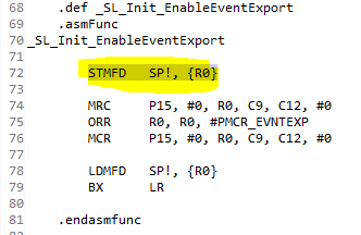

  • The start-up sequence in the Safety Library demo app does need to be changed.
    My recommendation is :
    void _c_int00(void)
        SL_Init_R5Registers();
        SL_Init_StackPointers();
        SL_Init_Memory(RAMTYPE_RAM);
        _SL_Init_EnableEventExport();
        resetReason = SL_Init_ResetReason();
    In the original sequence, _SL_Init_EnableEventExport() call may cause the double-bit ECC error. The first instruction in this function is a store to the stack, which will cause the double-bit ECC error. However since the event-bus export is not enabled at this point, there is no response or indication for this ECC error.
    The function call resetReason = SL_Init_ResetReason(); can also cause 2-bit ECC error. This is a C function, which also uses the stack to save and restore CPU registers. The double-bit ECC error caused by this stack write is now exported to the ESM. This is the cause of the ESM group 3 error that you see on power-up.
    Please call the memory initialization function before the call to enable event export. This memory initialization function in the demo app is not using stack operations as the return value is defined as a "register", so it uses a CPU register to hold this variable.
