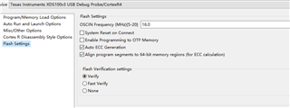

The program cannot run, unacceptable field reliability problems, the program can be erased, cannot be re-burned write, burn write prompt error as follows,Please help to analyze the cause
[ERROR] CortexR4: File Loader: Memory write failed: Flash algorithm returned an error during Flash programming. Note: Auto ECC generation is on, please make sure that the data sections are 64-bit memory aligned in your linker file; alternately, turn off Auto ECC generation in the On-Chip Flash settings

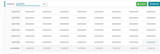

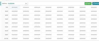

  • Can the flash sectors be erased? If not, can you figure out the failed address? If the sector is erased successfully, the content of the sector becomes 0xFFFFFFFF.
    Please enable the flash verification, so the failed address if any will be printed on the console:
  • Dear,QJ
            The flash memory of the faulty chip can be erased. Please see the following picture for the read flash memory。The writing mode of all chips is the same as that provided by you. Please see the picture for the writing environment。At present, it is found that this chip is faulty and can be erased, read, but not written.
