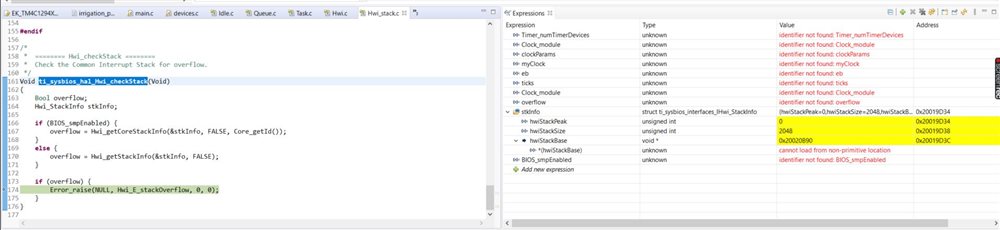

    One curious thing I noticed is we have our halHwi.checkStackFlag = true in our RTOS config. Every so often, the flow breaks off from the idle task to run ti_sysbios_hal_HWI_checkstack() and it seems to be indicating there is an overflow every time.
    Stack size in the picture is 2048 and I have tried increasing to 4096 with no success. I doubt the stack size is the actual problem, once again as the same configuration works at 0x00. Does this finding raise any antennas? I'm assuming the HWI stack overflow would certainly mess up HWI functionality and therefore timing/callbacks.
