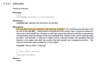

It seems to me there's some problem between SysTick interrupt and PendSV interrupt used by the OS scheduler. The scheduler uses following functions ...
// Add scheduler interrupt request
ABC_IRQ_SET_REQUEST(ABC_INT_SCHEDULER);
// Remove scheduler interrupt request
ABC_IRQ_CLR_REQUEST(ABC_INT_SCHEDULER);
// set a specific interrupt request
#define ABC_IRQ_SET_REQUEST(IRQ_ID) MAP_IntPendSet(IRQ_ID)
#define ABC_IRQ_CLR_REQUEST(IRQ_ID) MAP_IntPendClear(IRQ_ID)
// IntPendSet from TivaWare driverlib
void IntPendSet(uint32_t ui32Interrupt)
// Pend the SysTick interrupt.
HWREG(NVIC_INT_CTRL) |= NVIC_INT_CTRL_PENDSTSET;
Can't you see there any problem?

    When I change the setting of pending of PendSV interrupt in the following way ...
    HWREG(NVIC_INT_CTRL) = (HWREG(NVIC_INT_CTRL) | NVIC_INT_CTRL_PEND_SV)  & ~NVIC_INT_CTRL_PENDSTSET;
    so I set the NVIC_INT_CTRL_PENDSTSET of the NVIC_INT_CTRL register to 0 every time I'm setting the PendSV interrupt, the behavior is correct.
    Our operating system uses the calling of IntPendSet function with FAULT_PENDSV parameter for switching between threads.
    My idea of the problematic situation is ...
    - HWREG(NVIC_INT_CTRL) = (HWREG(NVIC_INT_CTRL) | NVIC_INT_CTRL_PEND_SV) is not atomic operation
    - it could happen that between reading the NVIC_INT_CTRL register and it change  + writing back, it's interrupted and the NVIC_INT_CTRL_PENDSTSET is set to 0 value. But since the original read value of NVIC_INT_CTRL_PENDSTSET bit is 1, it's rewritten once again and the SysTick interrupt is raised once again.
    - I was able to simulate this behavior. After some time, when the read value of NVIC_INT_CTRL_PENDSTSET bit was 0, I did following operation ...
    HWREG(NVIC_INT_CTRL) = HWREG(NVIC_INT_CTRL) | NVIC_INT_CTRL_PEND_SV | NVIC_INT_CTRL_PENDSTSET;
    which set the NVIC_INT_CTRL_PENDSTSET to 1. This really causes the raising of the SysTick interrupt after too short time with the sign that the SysTick timer didn't timed out.
    Do you agree with my results, does it makes sense to you?
    But how should I fix it? How could I ensure that the HWREG(NVIC_INT_CTRL) = (HWREG(NVIC_INT_CTRL) | NVIC_INT_CTRL_PEND_SV) operation is not interrupted?

  • Hi Zdenek,
    During the investigation we've noticed today that all the bits of the NVIC_INT_CTRL register are read only, write only or reserved
    That is not true. NMISET, PENDSV, and PENDSTSET are all labelled 'RW' and thus are Read/Write.

    - it led me to the Interrupt Control and State register (INTCTRL), which can be used for raising SysTick interrupt. We use the  IntPendSet function from TivaWare to handle the INTCTRL register. But we use it just for raising of PendSV interrupt
    - as can be seen in the IntPendSet function, the PENDSV bit in the INTCTRL register is set by the code HWREG(NVIC_INT_CTRL) |= NVIC_INT_CTRL_PEND_SV. This piece of code means, that the actual value of INTCTRL register is firstly read, then the PENDSV bit is added and the result is written back, which is several instructions
    - we found out in the data sheet of the controller that writing of 0 value to any of RO or RW bits of INTCTRL register has no effect, just writing of 1 should influence the exception pending. So I reused the IntPendSet function of TivaWate and just changed the command in following way ... HWREG(NVIC_INT_CTRL) = NVIC_INT_CTRL_PEND_SV. This way just the value of PENSV bit is 1, the rest is 0, but it should be correct according to data sheet information
    - I tested the FW with this change and the results were perfect. The SysTick interrupt worked correctly, there were no additional SysTick intrrupts and the rest of the system worked correctly
    - my understanding of the issue is that the HWREG(NVIC_INT_CTRL) |= NVIC_INT_CTRL_PEND_SV operation was interrupted after reading of INTCTRL register actual value (where PENDSTSET bit was 1), because it's not atomic instruction. In this interruption the SysTick pending was cleared. Then the operation is finished, but the read PENDSTSET bit was 1, we set also PENDSV bit to 1 and wrote back. And the PENDSTSET bit causes to raise additional Systick interrupt.

  • Hello Zdenek,
    Thanks for confirming the results of the change vs the original code.
    I ran some additional experiments on the project I had put together previously and confirmed your findings.
    The two solutions to avoid the issue would be:
    1. As proposed, just use HWREG(NVIC_INT_CTRL) = NVIC_INT_CTRL_PEND_SV
    2. Before calling IntPendSet, disable interrupts to that IntPendSet can resolve without an interrupt firing.
    For your application, 1. should be just fine to use to solve this issue. While 2. would be the most foolproof way, it may add a small amount of delay in the SysTick being serviced.
