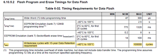

What is flash write/erase endurance for emulated EEPROM?
Is this the same as Data Flash write/erase cycles in below table?
